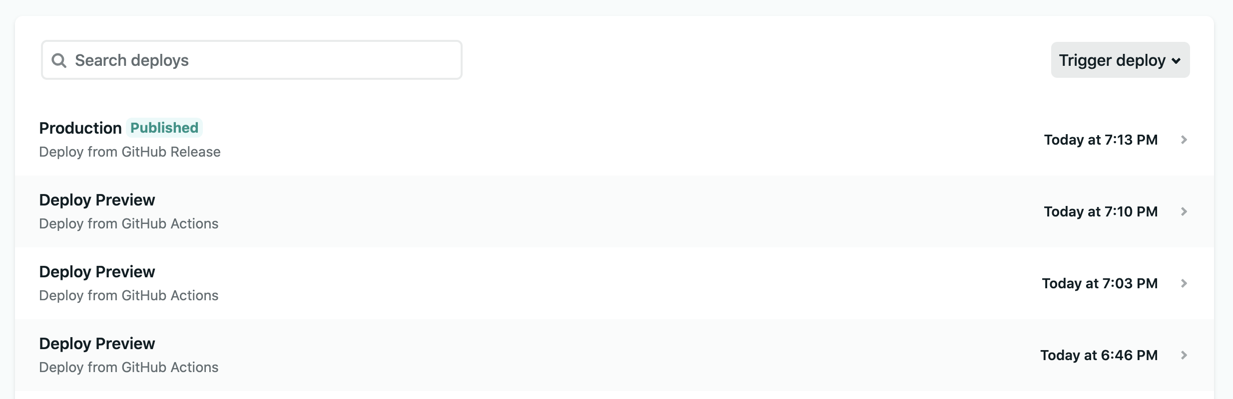

I believe the problem is because I am not using Netlify builds, I am instead using the Netlify API (through nwtgck/actions-netlify) to deploy a dist built in my GitHub pipeline. If I look in the “Deploys” tab of my site I do see deploys listed and I do see a Published deploy.
My question is: do these badges actually refer to the deployment of builds instead of deploys? Are they compatible with deploys via the API?
