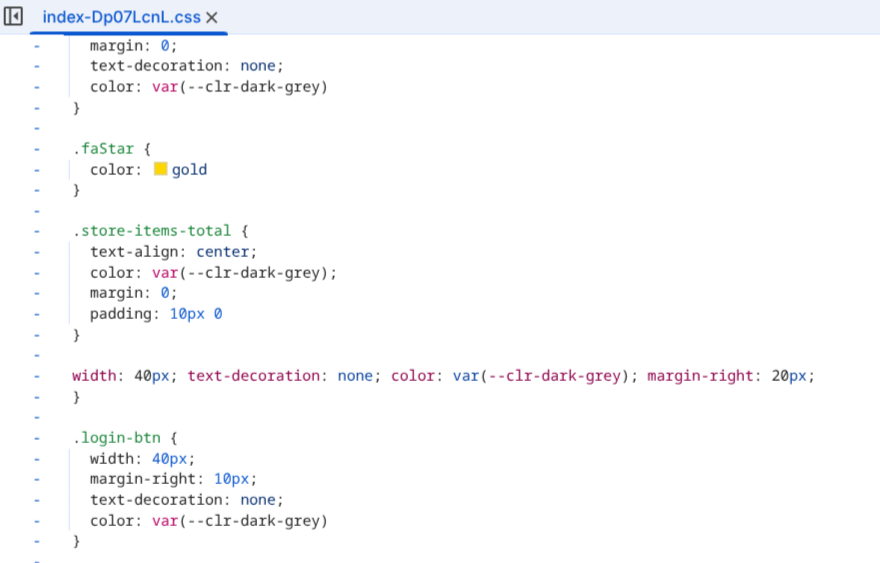

@ritchmat89 It’s not valid CSS…

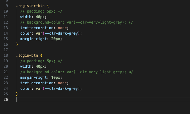

Hi @nathanmartin
Thanks for the reply.
This is what it looks like in my vsCode. I don’t understand why its converting from my vscode format to the version in your screen shot. Can you help?
There seems to be an issue with having CSS in there own component files. As soon as I add the css to the main app.css all the styles appear and work fine. I dont understand why there individual component css files are getting the error when the code in VScode is correct.
@ritchmat89 Run your build locally and check the files that are generated.
I suspect you’ll find that the problem occurs during your build, and is unrelated to Netlify.
Why it is happening I couldn’t say, I don’t work for Netlify and don’t have time to investigate for you.
It seems like you’re starting to pin it down though.

The frustrating thing is that if I run the project locally it works 100% with no issues. It was only when adding it to Netlify did the errors occur and the css didn’t work for certain components.
It appears like copying and pasting that css from the component css file to the main app.css file solves the problem. I dont know why this is the case and will try to figure it out.
Thank you for your help.
