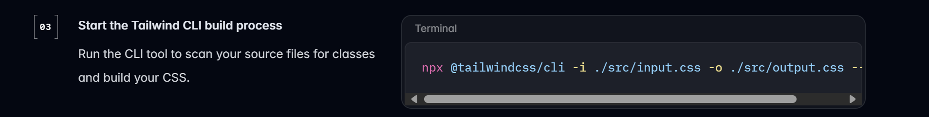

I’m encountering an issue with my site build on Netlify. Locally, everything works perfectly: Tailwind CSS builds without any problems. However, during the Netlify build process, I get the following error:
sh: 1: tailwind: not found
My build command in netlify.toml is:
npm install && CI=1 npm run build
And in my package.json, the build script is:
“build”: “npx tailwindcss -i ./src/input.css -o ./dist/output.css --minify”
Despite this, the Netlify build cannot find the tailwindcss binary.
