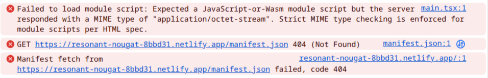

- No meaningful error in the browser console.

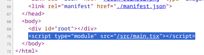

The errors in the browser console are meaningful.
Inspecting why they’re occurring reveals that ‘source code’ has been deployed:
Your project will only work correctly anywhere where you:
- have the right environment
- run the right command
- serve the right output
If you fix the configuration, it’ll work fine on Netlify too.

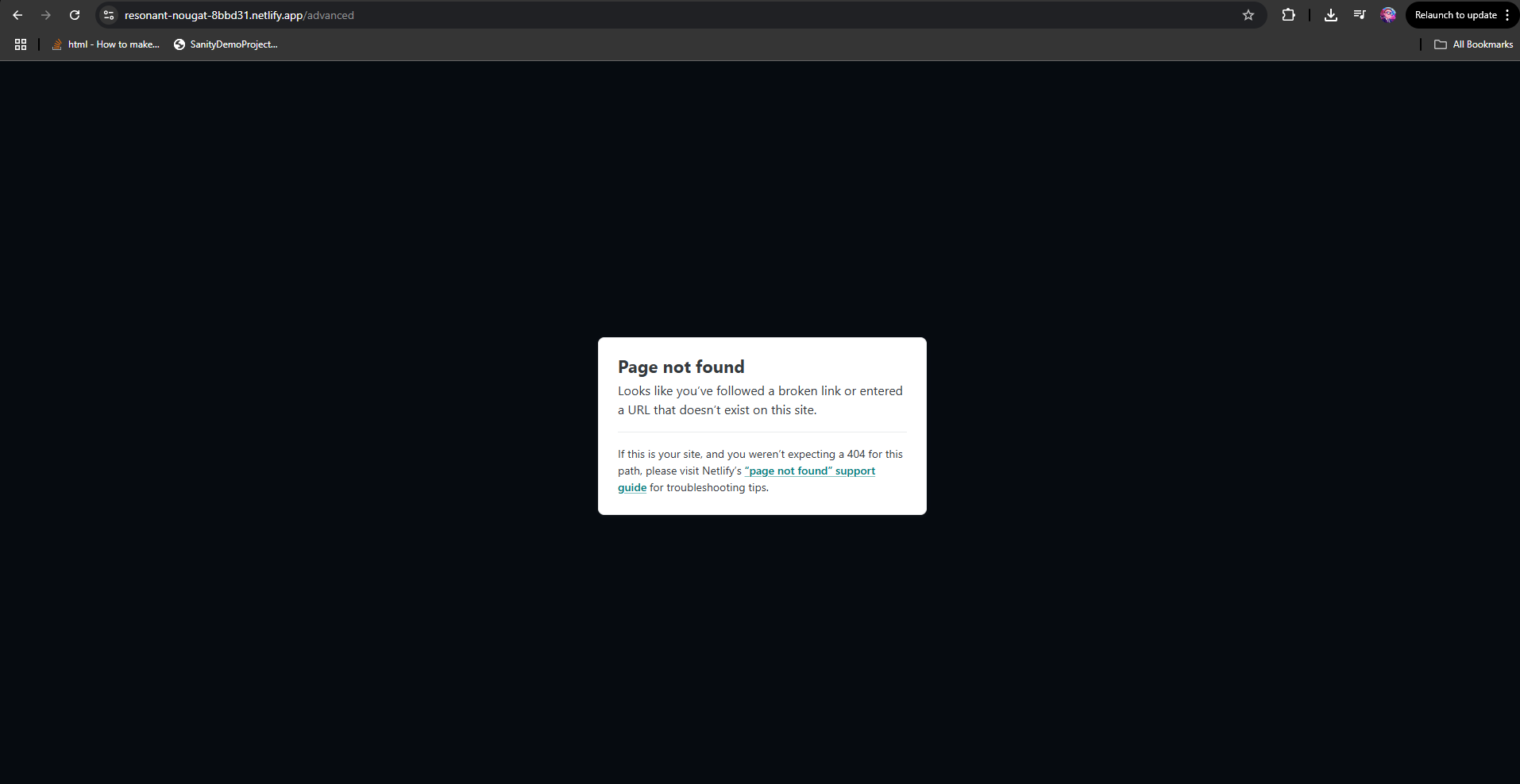

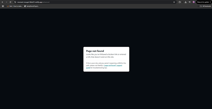

Already tried that, it works but after some redirections, my pages starts giving 404
Only when I again goto homepage and get back on the page, it works.
