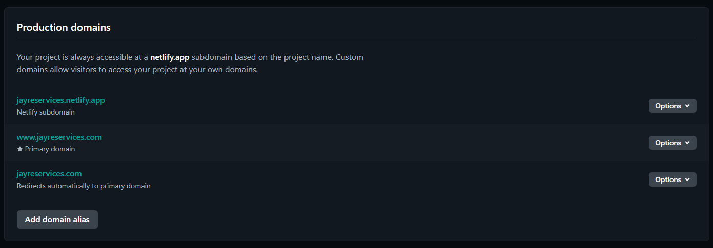

Hi, I have a website hosted here in netlify and the domain was bought in bluehost. In bluehost, the DNS was already configured as stated in the docs:
A @ 75.2.60.5
A @ 99.83.190.102
CNAME www jayreservices.netlify.app
I have two production domains:
Primary: www.jayreservices(.)com
second: jayreservices(.)com
My problem is that, when i visit the jayreservices(.)com, Its showing a “connection to this site is not secure.”, even though the DNS was already configured correctly and it is showing under HTTPS SSL/TLS certificate:
Domains
jayreservices(.)com, www.jayreservices(.)com
I already added _redirects https://jayreservices(.)com/* https://www(.)jayreservices(.)com/:splat 301! in the public folder of my project.
Not really sure if I did forget something, but please help me out. Thanks!
This is incorrect, you won’t find 99.83.190.102 anywhere in the documentation.

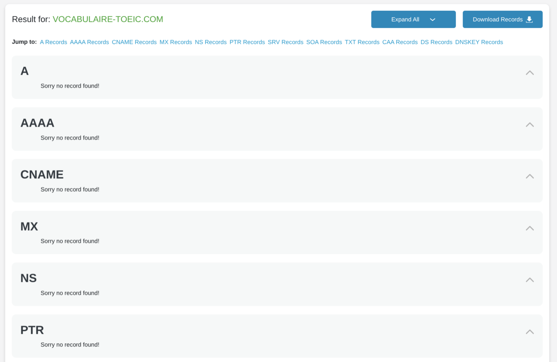

@JeanDirel Please don’t hijack threads created by others.
The domain that you’ve referenced doesn’t have any DNS records:
https://dnschecker.org/all-dns-records-of-domain.php?query=vocabulaire-toeic.com&rtype=ALL&dns=google

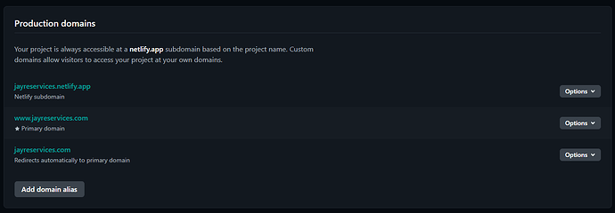

Hi, thank you for your response. I already removed this in my DNS record setup in bluehost “99.83.190.102”. However, I’m still getting the same issue. Please see attached screenshots for my configuration setup:
image100%75%50%
In my DNS provider(bluehost), this is my updated configuration:
A @ 75.2.60.5
ReplyClose
@maw1e You may just want to give it a bit of time, as the site loads fine for me:
Thanks a lot @nathanmartin. I’ll try to check again tomorrow. I appreciate your help!
