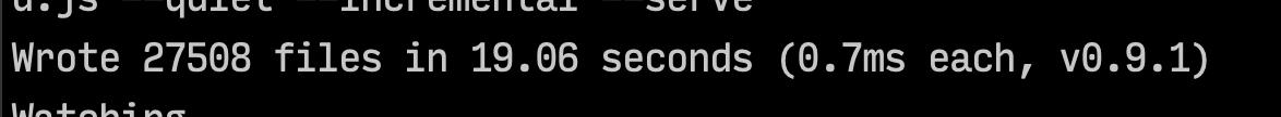

what SSG are you using? Hugo is supposedly the undisputed speed champion. However, I’m fond of Eleventy, and its performance is formidable.
Good to know. Thank you. I’m using Gatsby.
We started with Gatsby too, but abandoned it for more flexible, less opinionated SSGs are which easier to use.
Maybe useful, this guy writes a bit about switching from Hugo to Gatsby to Eleventy.
