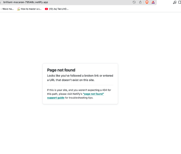

Whenever i upload my bolt project to netlify by whichever method it always show the 404 error landing page.I tried the inbuilt bolt deployment method using git and even tried dragging and dropping all the contents inside the dist file but it just doesn’t work.

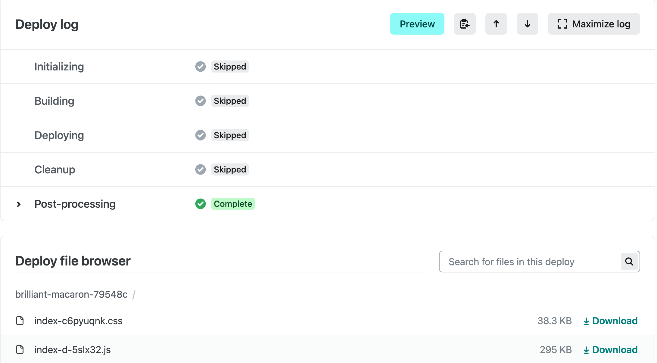

I have checked with bolt support team and they have said its not an issue on their side. Also i have checked and the index.html file is present with the right code. The Deploy FIle Browser is this:
As far as I know they always say this, even when it provably is.
There is no index.html shown in your screenshot.
There is an index-c6pyuqnk.css and an index-d-5slx32.js but no index.html
Try taking another screenshot.

If you actually upload a structure of:
dist/index.html
dist/assets/index-C6pYUQNK.css
dist/assets/index-D-5slX32.js
Then that’s what you should get on Netlify.
The structure you showed in your last screenshot above is only the files in the assets folder.
