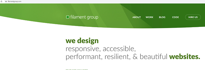

hi there!
I am seeing this today when i pull up filamentgroup.com
is this what you were expecting to see?
Hi @perry
Thanks for taking a look. Sorry my question is a little confusing. I pointed the A record back at the IP of our old host again until I could figure out where it should point instead. So yes, it should look mostly like that, but when it’s pointed at Netlify, we’ll know because the homepage animation is a lot faster. https://filamentgroup.netlify.app/
