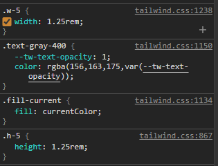

The problem is because w-5, h-5 are setting the width and height attributes:
While the w-4 and h-4 aren’t doing anything. So you need to check that.
For example, I manually added the styles like this:
You can see it works:

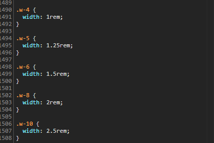

I don’t know what to say. Your Vercel build has this class in the tailwind css:
The Netlify one, doesn’t:
I’d take this to be a problem of something like PurgeCSS if you’re using it.

Again, thanks so much for your help so far! You are absolutely right about the missing “h-4” style in the netlify build as compared to the vercel build and local build (local maybe misleading as it is the yarn build that writes prod version to /build folder). So I installed netlify dev for the cli and ran the cli tools to create the build locally and then “$ netlify deploy --prod” to move the local build to netlify.
Which fixes it. “h-4” now appears in the deployed css. Stars are now the correct size. I will use this method from now on. Does it mean that there is a glitch in the netlify on-line build process?
