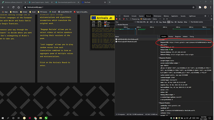

Well, I just checked the Network tab and the only fonts I found are being loaded from Google Fonts. There don’t seem to be any fonts that you’re hosting on Netlify.
It’s the ArielUnicode.ttf
Forgive me, I’m helping an artist deploy their work for an exhibition, so I’m not familiar with the structure. How can you tell it’s a Google Font?
And still I don’t understand why the download time for that file would be different when the main code is deployed on Netlify when compared with the staging site. We’re talking 20+ seconds on Netlify vs 2 seconds at the other location.

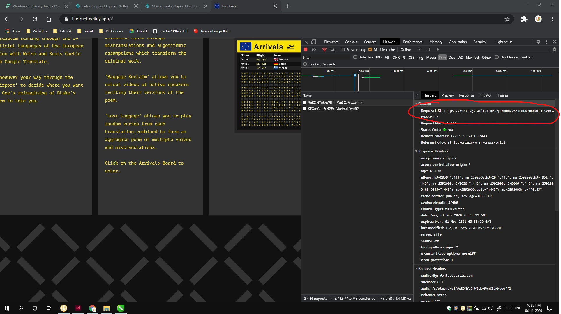

I don’t see it. This is all I get:
The address says so:

Okay, got it. It’s a 23.3 MB file, so, no wonder it takes time to download. To me, it took 1.6min:

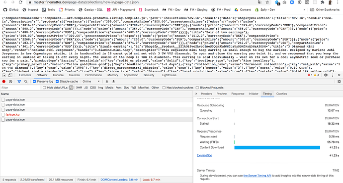

Waiting 700ms of TTFB and 2.44s of content download for a 822Kb js file. This is not acceptable for a smooth UX.
x-nf-request-id: 2b1d4809-10f9-40d2-b4e2-0c2446118dd3-29656008

There must be something wrong with your logging system. The file is definitely not 3040kb.
Attached is the loading time for the file of 660kb. Even if this is somehow 3040kb as you claim, it is still completely unworkable for us.
To be frank I think there is something wrong with your monitoring system, or you are not measuring the delivery all the way down the pipe. Files on Netlify are just generally dreadfully slow for us. It doesn’t make a huge difference for small files, but for just slightly larger files, it becomes unusable.
It’s not that I don’t understand the concept of caching, hit rates, CDNs and edge nodes. But I have never in my career seen a CDN with this poor performance.
