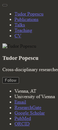

Sorry to come back to this, but it might be related: after updating the contents of the landing page of my site (_pages/about.md) and rebuilding as per the above (via curl -X POST webhook), that page shows as unformatted text, and the avatar image also does not show:
29-10-2020, 17.21.07
I suspected some syntax error like an unclosed quote or something in the _config.yml or in about.md (as in this similar thread), but after checking all files in my repo, I"m at my wit’s end what else to try!
It might be telling that when I try to load my site from the tudorpopescu.github.io URL (instead of tudorpopescu.com), I get a “404 There isn’t a GitHub Pages site here.” error, whereas other websites based on the same academicpages template (e.g. this guy’s) load fine.
Unfortunately there is no more support from the forked repo itself, so am not sure where else to get help. Thanks again if you can spare a bit more time for this!
You’re referencing CSS files from a site on GitHub. We’re Netlify, not GitHub! :slight_smile:
They’ll be referenced either using a URL (or similar variable) in Jekyll which should no longer point to the GitHub site or in-line within the code.
