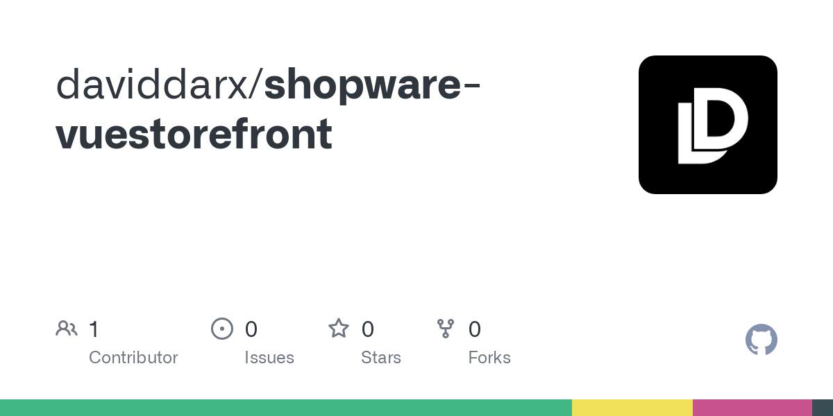

Hi everybody,
I am trying to deploy a shopware-pwa website but am struggling .
Here is my git repo:
