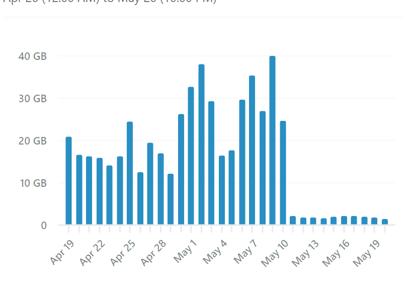

The proof is kind of obvious when the resource usage goes from 3-4 GB to 40 GB. Google is not stopping the indexing just because you disable the pre-rendering. Google is not failing the indexing because you stop the prerender. Google works perfectly fine with javascript driven websites, mostly, but it depends on loading times and speed to index properly and not “cut off” mid-process. Which is why a prerender is a better alternative, to ensure availability to the search engine.
The prerender is not doing anything different then what Google is doing already, it’s the same content, same website, same images, same javascript, only difference is that Netlify is handling it before Google does. And as soon as you add Netlify as a middleman, the bandwidth resource jumps through the roof.

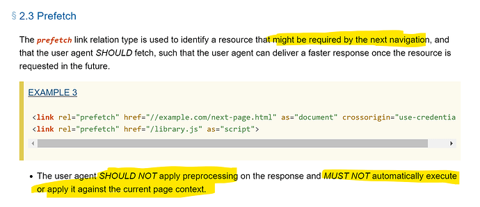

This looks like a serious bug too. As per W3C specification, prefetch attribute should not be used for any kind of pre-processing. It indicates resources that might be used in the future upon navigation. But prerendering generates only current page, there is no future navigation hence this resource should not be downloaded.
See HTML Standard
Hi, @maintopbiz. It isn’t pre-processing though and I don’t know why you think it is. Are you saying Chrome shouldn’t prefetch prefetch links? Because that is what Chrome does and will always do. The prerendering service is just running headless Chrome and headless Chrome prefetches when told to by HTML.
If you would like to see the behavior changed, that repo is public and you are free to file issues there to request a change.
Our prerendering service is in beta. You are welcome to use it if it meets your requirements. If you would prefer to use a third-party prerendering service we support several other services as well.
@freddy, I’m not sure what you are saying? Did you test the prerendering service locally? If so, what did behavior did you see?
@luke I am just saying that downloading links with “prefetch” attribute for prerendering purposes is wrong. It just artificially increases bandwidth. These assets shouldn’t be downloaded. I don’t know if and how it can be changed in headless Chrome. I would expect it to be your job to find out. You are selling prerendering under Netlify brand.

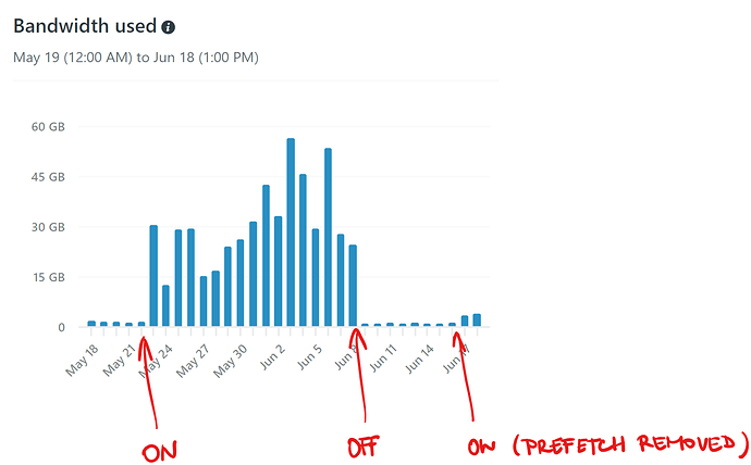

Just an update. Removing prefetch attributes helped. The prerendering is no longer causing huge bandwidth costs. However, the website now feels much slower for the users because the assets cannot be prefetched. This is still a bug in prerendering service that needs to be fixed. Resources with prefetch attribute should not be downloaded during prerendering. We just decided for now to deteriorate the user experience in order to save the bandwidth costs.
Appreciate the loop-back, @maintopbiz. Fingers crossed, the dev team can consider a better approach for prefetch attributes when the beta feature is revised!
