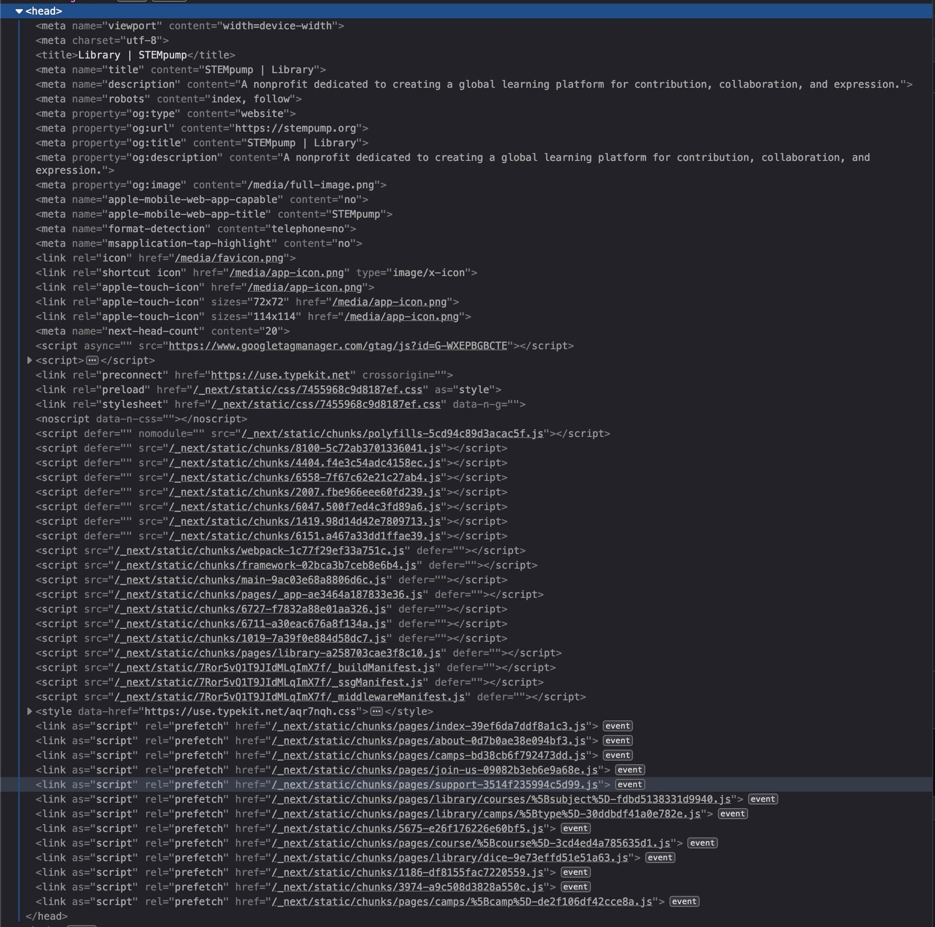

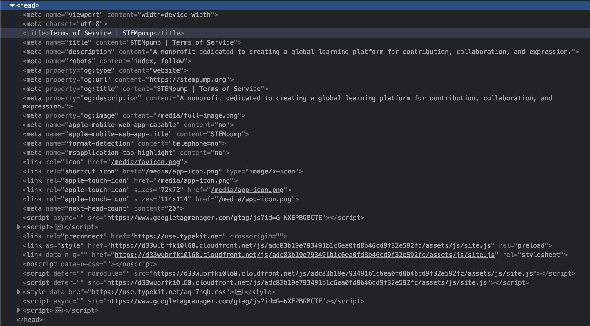

The difference is in the <head>, and the linking of resources such as CSS and JS.
From a working page
And a non-working page

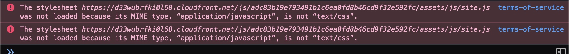

with these errors
It appears the pages that don’t work are using assets that are optimised. Are these pages part of the main site or are they separate sites behind a rewrite?
