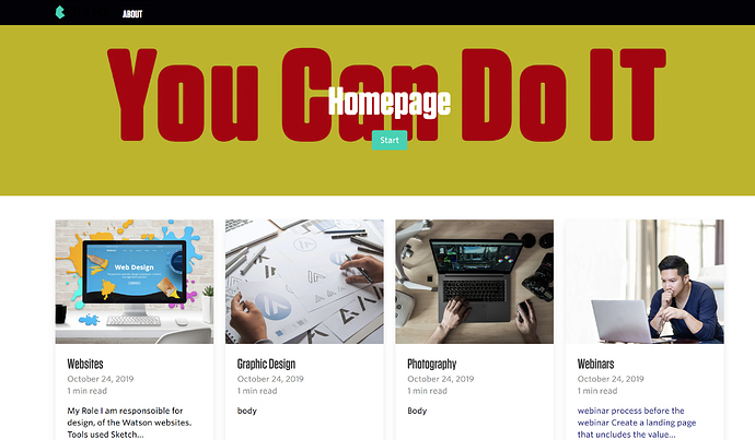

Old version of website shown, what could cause this?
Hi, I am having an issue that I believe is caused by the Headers on my site, but I can’t seem to figure out the issue. When I initially load the site, I am shown an old version. After using clear cache and reload in Chrome the correct version is shown. Then if I reload again it shows the old version again.
The site is https://marketingsuperpowers.com
The correct version has a black menubar at the top. The incorrect version has a blue menubar.
The correct version:

Hi, thanks for the quick reply. I can confirm that my repo looks correct, the items is deploying from Master and I can push changes to it and have them show up correctly on the site - when the correct version is displaying. There are some javascript error, the site is very much a work in progress, but I don’t see any javascript errors that would cause this issue - that I know of.

hmm maybe its just an issue with my computer. Safari shows me the incorrect site, as does Chrome. But Chrome in incognito shows the correct site. Safari on my phone also shows the correct site.

Hi @Blake32p, I see you have custom cache-control headers set and those are most likely what’s causing the issue. I recommend letting us handle caching for you and see if you have a better experience. You can do this by removing the cache control headers you’re sending your deploy then wiping the cache in your browser for the site. Let us know if that works out for you. Note that you can read more about how we handle caching in the following blog post: Better Living Through Caching

Hi Gerald, thank you for replying to my post. I removed the netlify.toml that had the custom headers. Is that enough to reset the settings so Netlify can handle the cache? Also I added the code back in that has the 403 issue.
Hi, @Blake32p. I also notice that this site is using a service worker:
Service workers act as an intermediary for any HTTP requests for a domain/site. They can, will, and often do override what Netlify will send as a response in many cases. If you are seeing an incorrect version, it can be helpful to double check if that content came from Netlify or from the service worker using the local cache.
That was it! I didn’t realize I had to unregister the service worker. I followed the instructions here on removing the service worker and that solved my issue. Thanks so much!
