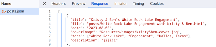

There is a posts.json file loading at runtime, and it does contain those tags:
Checking the code that you have to load and process that json:
The line:
const currentFile = window.location.pathname.split('/').pop();
Will return:
'white-rock-lake-engagement-with-kristy-&-ben'
You then perform a find on the posts with:
const post = posts.find(post => post.file.endsWith(currentFile));
The key in the json file is:
"file": "posts/White-Rock-Lake-Engagement-with-Kristy-&-Ben.html",
As I’m sure you can now see, there are a few things wrong with this.
If you weren’t aware endsWith is case-sensitive:
This method lets you determine whether or not a string ends with another string.
This method is case-sensitive.
You’ll need to adjust your handling accordingly.
The reason you never saw an error in your log is because there is no error, the if ( post ) just never does anything when there isn’t a post found, which is what’s happening.
