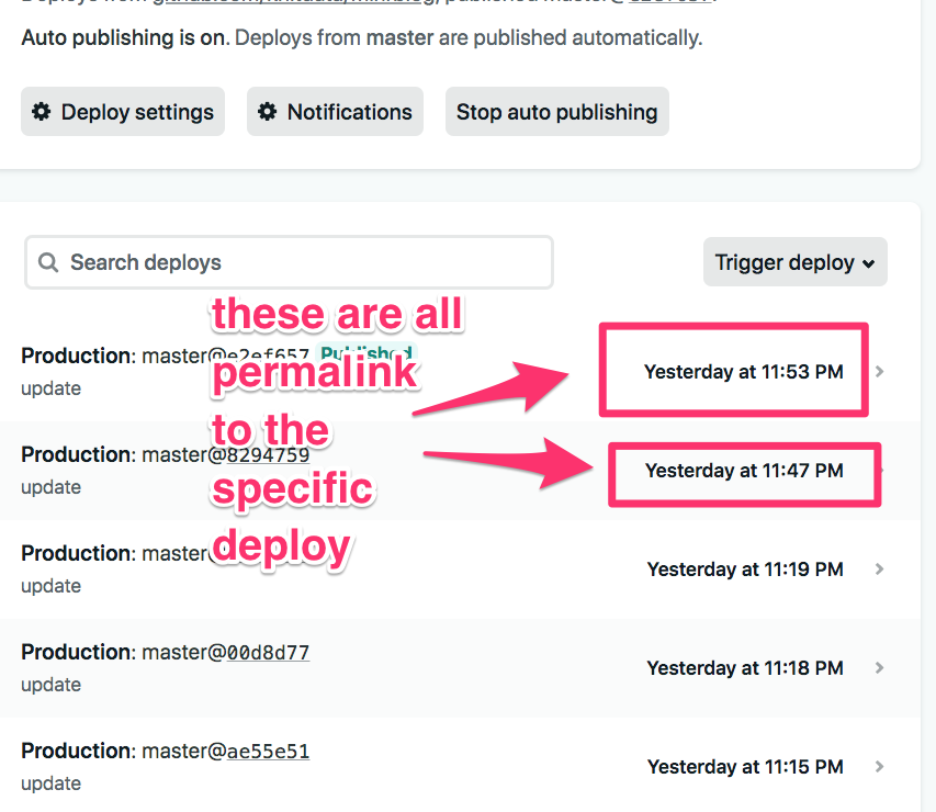

You could link me to an old deploy with the form failing to work, if you’d like me to look further (not sure if you knew but there is a permalink for each deploy, as shown in this screenshot of the deploy listing page):
