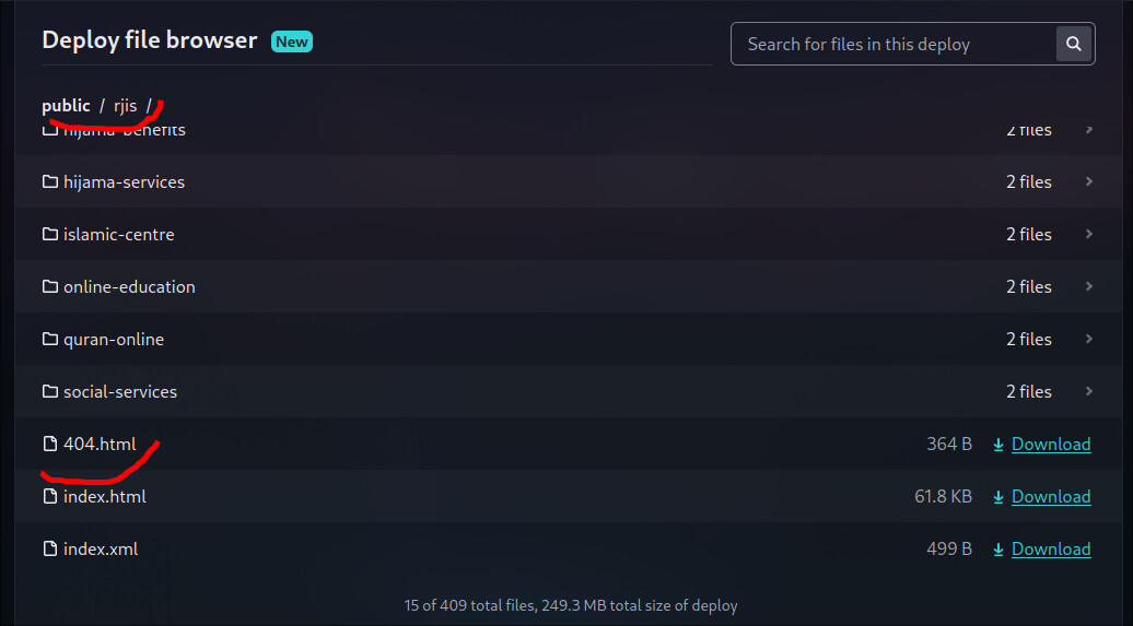

Can you run your build locally and make sure it is actually outputting a /main/404.html and /rjis/404.html into your Publish directory.
but they do
building locally does output the files
@YasirRWebDesigner Those are different URLs, notice the trailing slash.
The rjis one you reference is actually here:
https://gleaming-fenglisu.netlify.app/rjis/404/index.html
I’m not sure what’s going on with the main one, which isn’t here either:
https://gleaming-fenglisu.netlify.app/main/404/index.html
You really should just check what files are being output by your build, as it’ll shine a bit of a light on it.
As you’ve shown in the screenshots you provided while I was writing my reply, your files are actually called index.html and are in folders called 404, that isn’t what the Netlify redirects documentation states, nor what your redirect rules point to.
So you’ll need to make things align, by either changing where they output, or where the redirect points.

okay, so here’s what did and now it’s according to what you were saying to have a 404.html file in main and rjis. slightly different the main/404.html is in layouts/404.html like normal 404 file.
First in the .md files I removed the url: frontmatter and added
aliases:
  - /rjis/404.html
what this does is on top of a file in 404/index.html it also creates an other file named 404.html in the rjis dir.
I removed the url front matter because I think it was going to /dir/404/ and not /dir/404.html and guess what :smiley:
It still didn’t work not only that going to url/dir/404.html doesn’t show any pages, even though there’s a file
on the main/ or / the 404 page shows fine even if you goto url/404.html but that worked even before so :person_shrugging:
netlify.toml file
[[redirects]]
  from = "/rjis/*"
  to = "/rjis/404.html"
  status = 404
[[redirects]]
  from = "/*"
  to = "/404.html"
  status = 404
@YasirRWebDesigner It seems to work for me now?
This page ends up on the main 404 (the one that says oops):
https://gleaming-fenglisu.netlify.app/main/this-page-does-not-exist
This page ends up on the rjis 404 (the one that says rjis):
https://gleaming-fenglisu.netlify.app/rjis/this-page-does-not-exist
It’s working finally after 20 commits and 24 hours, it’s working… T^T
