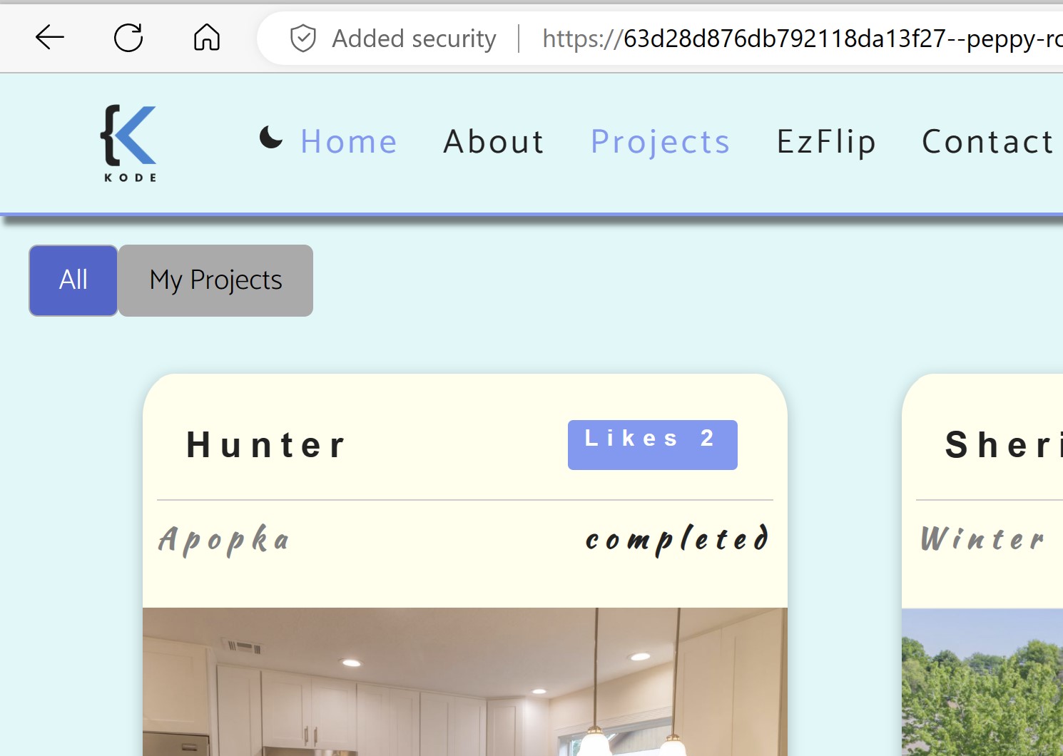

I run ntl deploy again and my site ( https://63c6e535b71e3075d53ef286–peppy-rolypoly-dd9af0.netlify.app) looks as I expect it to look at this stage!

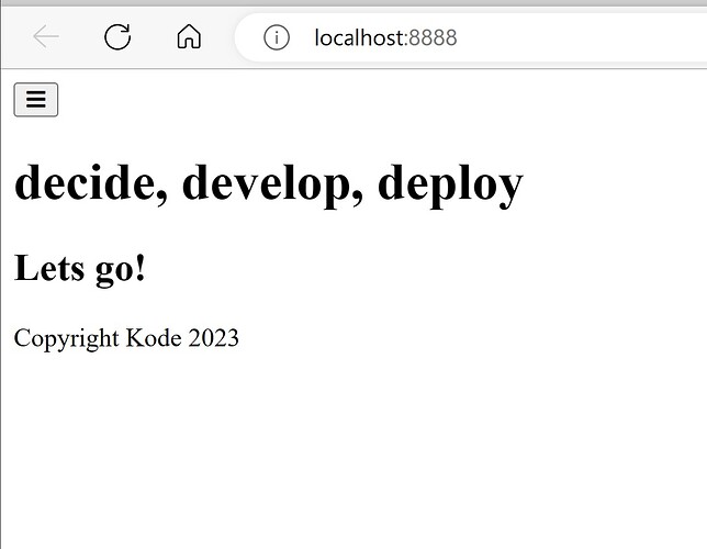

However, I try ntl dev and the site appears locally but it is a mess - it doesnt look too pretty online but its a real mess locally - navigation not working, css not working! It does show some stuff from some pages but its a disaster!
So I DELETE the build folder and try ntl dev again. This time it displays perfectly locally. But of course as soon as I try ntl deploy I have to npm run build and I run around in circles here.

hi Amelia, Thanks for the suggestion but whether I run ntl deploy or ntl deploy --build they both create a “build” folder and while that build folder is present, if I then run ntl dev, to continue development locally, the app appears but is a mess with nothing working. If I delete the build folder and run ntl dev then the app runs normally. Thats the issue.

To reiterate, the “build” folder causes a problem with ntl dev running the site locally (I just get a mess of text on the screen with nothing working - navigation/css - nothing). so instead of this…
