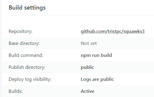

The build settings (typical Gatsby) with public repo:-
