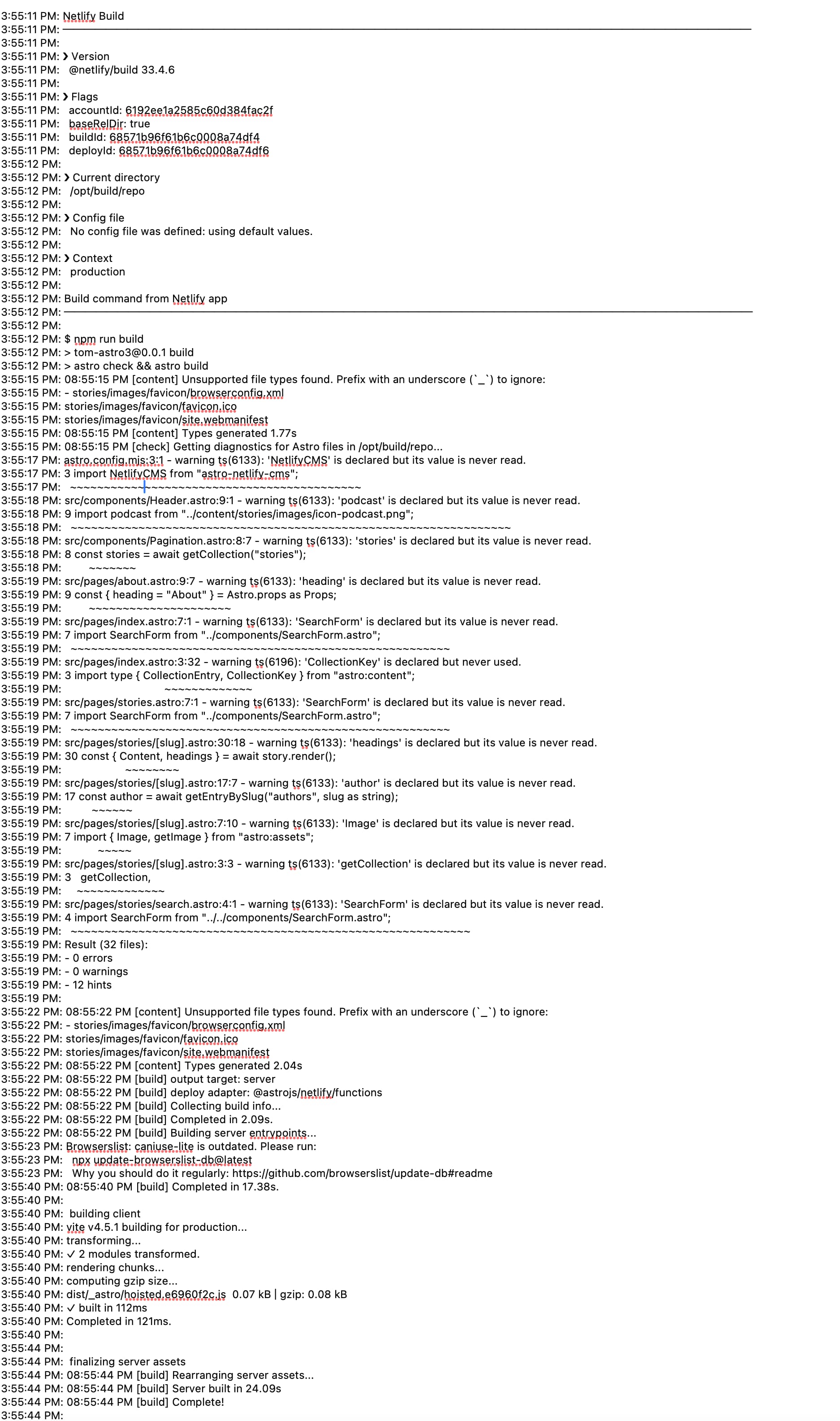

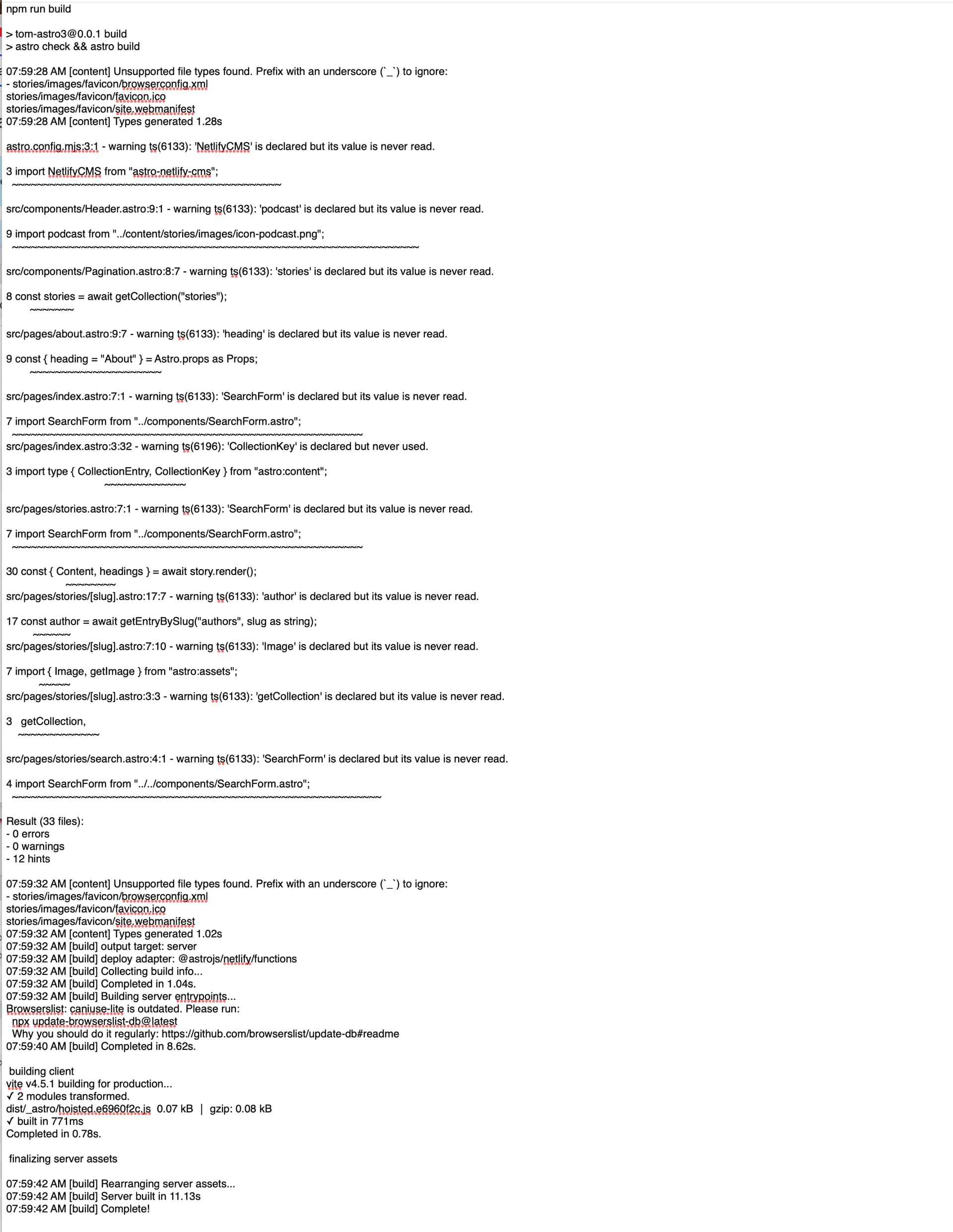

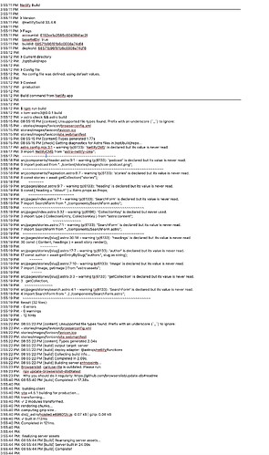

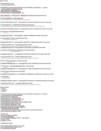

Comparing the logs appears to be the same.
From Netlify
Locally
