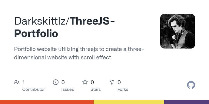

Hi @coelmay I’m also having trouble deploying my site through Netlify. Here’s my repo.
Are you saying I should create a public/img folder for all of my assets before running npm run build?
Hi @Darkskittlz
In your case, no.
The images are not referenced as img/FILENAME, rather simply as FILENAME. So rather than put the images in public/img, put then into public. The reason for needing to move the files into public (and the reason they are not bundled otherwise) is the images are not referenced in HTML (i.e. <img src="sun.jpg">) rather in JavaScript.
Thanks for your response. I’ve put the images in public and referenced them in my main.js but my netlify deploy is still not rendering the img files
https://threejs-portfolio-site.netlify.app/
I didn’t mean change the path in main.js.
You need to remove the ./public/ path from main.js and it will work.
Thank you sooooooo much @coelmay! That did work perfectly. I appreciate your help.

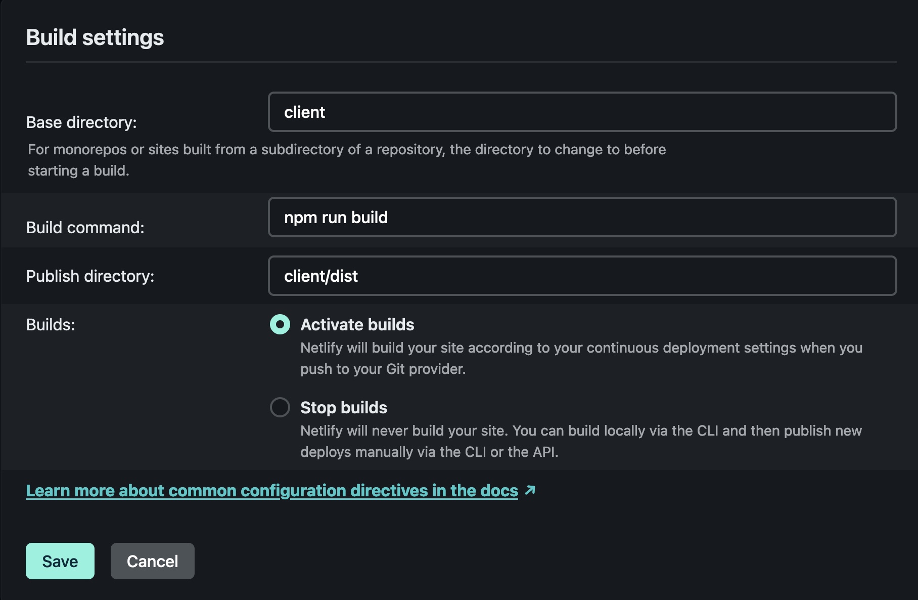

Hey @codewithnafiz
I can’t do this for you, but I can tell you how to fix it.
Inside client, you need to create another directory public and move the .jpg, and .jpeg files into it. This is because these files are not referenced in the index.html but in main.js so Vite does not copy them. public is the directory to use for assets you want copied during build (see Vite documentation.)
For Netlify build settings, you need to set client as the base directory and the publish directory to client/dist (client is automatically pre-pended to the publish directory when it is set as the base directory.) Then set the *build command to npm run build, and all is set.
You can remove the node_modules directory as this is not required. Netlify installs these modules during build.
If you have further issues, do respond here.
Suggested build settings for your project:
