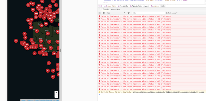

hmm. I am still seeing this in the developer console:
And I am getting a partial map on first load, but it’s not complete.
I’m not entirely sure what is going on here, if i am quite honest.
