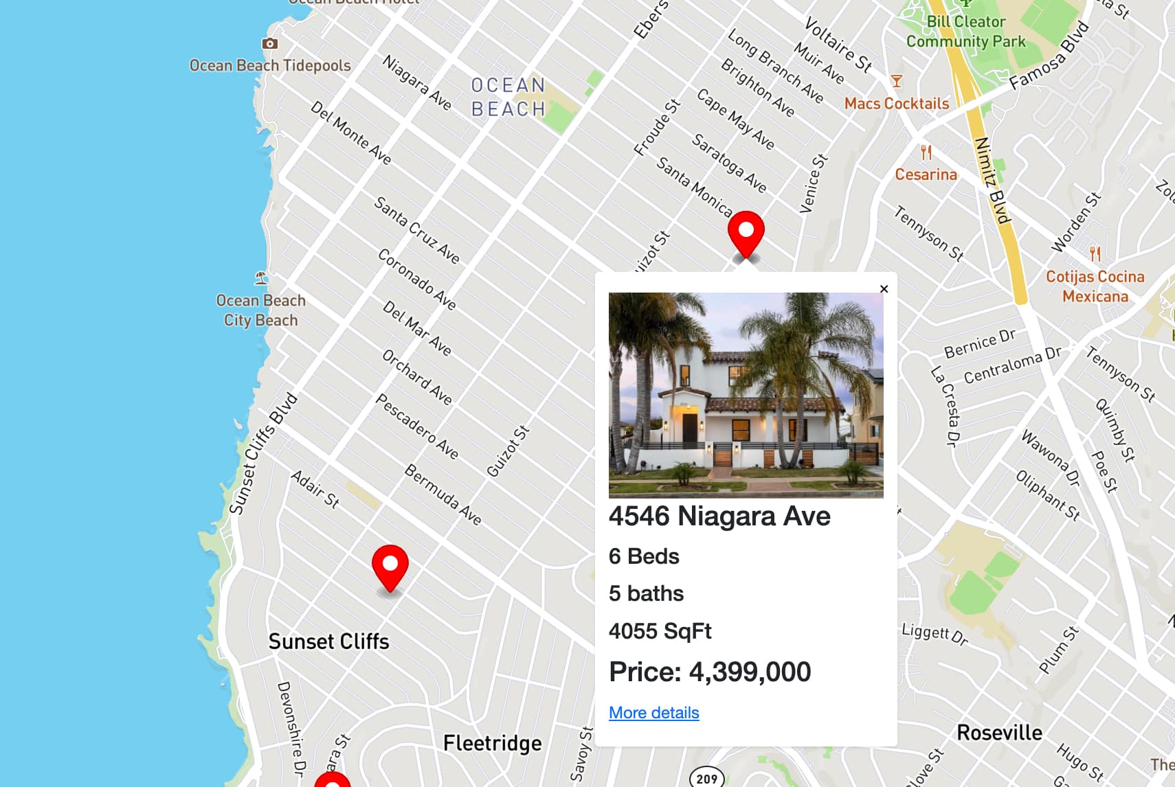

Thanks for reaching out and welcome to the Netlify Forums! When I follow the link to your site, it loads perfectly and I can engage with the map. This is what I am seeing:
Please let us know if you are still encountering issues. Thanks!
Thanks. I think the issue may have been with Maplibre. Therefore, I recreated it with Mapbox as all the other stack overlow suggestions weren’t working. I’ll close this ticket.
