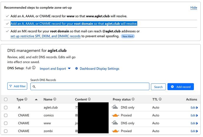

I had things working perfectly for years (Thanks!) but tweaked some things on cloudflare which has broken some thing. I just want aglet.club and www.aglet.club to work (getting certification errors for aglet.club).
I also need the subdomains (which are cloudflare tunnels) to work.
I have attached a screenshot (with some edits) of my Cloudflare setup which I am guessing is wrong…THANKS!

Thanks for this. I have turned off the proxy in Cloudflare for my website. I have left it on for the two tunnels into my exposed services on my home network. I have also left it on for the A Records for my home network.
All appears to be fine but I do not understand how and why this works?

What I do not understand is why when I login to Cloudflare I keep getting the following on my DNS page:
I have done what the have asked (www, root domain, restricted email) but that “next steps” shows every time I login?
From the screenshot, the configuration looks fine to me. However, I’m unable to see the records myself:

(1) and (2) work fine…and I now only have one A name and then 3 CNAMES (2 for the tunnels, 1 for www). So I think this is good.
But I can not get cloudflare to stop telling me:
Add an A, AAAA, or CNAME record for www so that www.aglet.club will resolve.
Add an A, AAAA, or CNAME record for your root domain so that aglet.club will resolve.
I just do not know why Cloudflare is giving that suggestion…
I can confirm the setup looks good as far as Netlify is concerned. To get rid of the UI warnings, I think you might have to ask Cloudlfare on why their UI is showing it.
I think Cloudflare was in a weird state. I deleted everything but the two CF tunnels. The tunnels are the only reason I am even on Cloudflare. I then deleted my two entries for Netlify and re-added them. Everything worked fine but I was still getting the “suggested next steps”. Super frustrating.
So then I deleted all the email records just to try to fix that. That all worked and then “magically” the ANAME and CNAME warnings went away.
I think the email setup may have been an issue. I do not do email - I just wanted to block its use.
