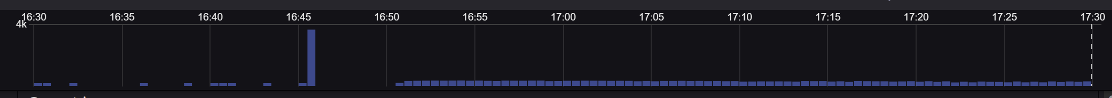

Okay let me ask a different question… did it start working later or does it still appear to be blocked? I’m, asking because, based on logs for June 29, 2023, 16:30 to 17:30 EST, I can still see successful requests:
We have implemented a workaround through the edge proxy as I mentioned above. Seeing successful calls to the function is not necessarily proof there was not a problem.
