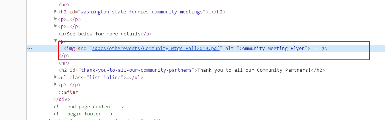

and slightly further down on the page, you are actually linking to a pdf file, as opposed to an image:
I’d go through your project and rule out that any of these broken images are being caused by issues unrelated to LFS first! :smiley:
