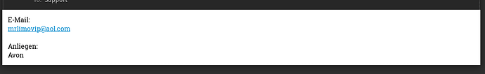

I have attached a screenshot of one such response. I am quite at a loss what actually happens here and would be thankful for any information or troubleshooting support.

The best way to prevent spam is to implement both a honeypot, which you have, and a recaptcha. The recaptcha instructions are here: Spam filters | Netlify Docs.
Please give that a try and let us know if that helps.
Regarding the existing spam submissions, you can mark them as “spam” right in the Netlify UI. More on that here: Form submissions | Netlify Docs
