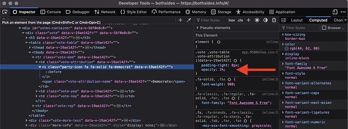

The site I’m working on: https://bothsides.info
Deployed fine via netlify, but the icons that are loading fine locally, are not showing up on my site after deployment.
I’m using a FA Kit, which references this script call:
<script src="https://kit.fontawesome.com/20e1d1eaf0.js" crossorigin="anonymous"></script>
I can see all the calls coming back from FA, so I don’t think it’s a content security or headers issue.
But the fonts are not showing up on my site after deployment.

The issue is to do with opacity, not the icons.
This is caused (usually) during CSS minification as mentioned in Percent values in @keyframes in CSS are incorrect only at build time. · Issue #6076 · vuejs/vue-cli · GitHub
Rather than using percentage values such as 80%
, use decimal such as 0.8
Also a note, if you are creating a new thread, please don’t post the same content on an existing thread.
D’oh! Fixed!
