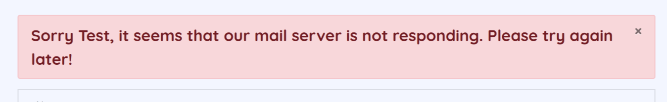

After submitting a form on my contact page, there is error code after submitting : it seems that our mail server is not responding. Please try again later!

The error that you’ve mentioned isn’t a Netlify one, so it’s likely you have form handling on your site that is trying to submit to somewhere that doesn’t exist, encountering a 404 for example, and then showing an error message that it has built in.
Thanks for the heads up, how do i Fix this?
@Obistann As I’d guessed your form is trying to post to /contact.php
And the error that is being displayed is being shown by your site code
To fix you should adjust the form according to the Netlify documentation:
