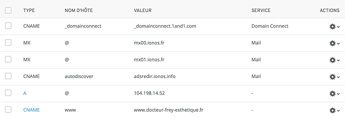

I’m in the process of moving a .fr custom domain name currently hosted on Ionos.
I wanted to know if my settings were okay.

I believe the CNAME for the www subdomain should point to your Netlify subdomain, not to your custom domain.
Also, unless you retain your account with Ionos, your e-mail won’t work. As it is, it might require some finesse to get ionos.fr to handle e-mail for a domain it’s not hosting. At any rate, good luck with that.
