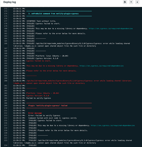

Hello everyone,
I am new to netlify and am having the following error preventing me from deploying my site on netlify.
I have tried reinstalling the cypress plugin and am still having the same issue. Any help would be much appreciated.

Hi @kent28 , welcome to the community!
I believe you opened a helpdesk ticket on this and was able to workaround the issue by switching build image to Ubunto 16.04.

Hi @kent28 , sorry I had you mixed up with another customer who wrote into our helpdesk with almost identical question!
The workaround at the moment is to switch your build image from Ubuntu Focal 20.04 to Ubuntu Xenail 16.04 in the UI:
Site settings > Build & deploy > Build image selection
Let us know if that worked!
It worked thank you! I noticed that the cypress plugin still crashed during the deploy though. Will this be a problem for future builds?
Thanks for suggestion i think this is helpful and solve my issue.

Hi,
I got the same error however it does not allow me to change Site settings > Build & deploy > Build image selection, Ubuntu Focal 20.04 (default) only. What should I do?

Focal is the default and only image available. You can simply disable the plugin: nextjs-blog-theme/netlify.toml at main · HoaLeMinh/nextjs-blog-theme · GitHub by removing it from there.
