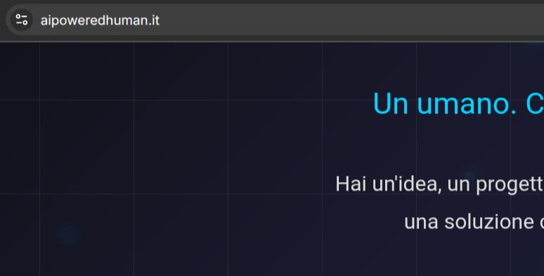

  • Working Page: The homepage (/) correctly loads and applies the stylesheet from /style.css.

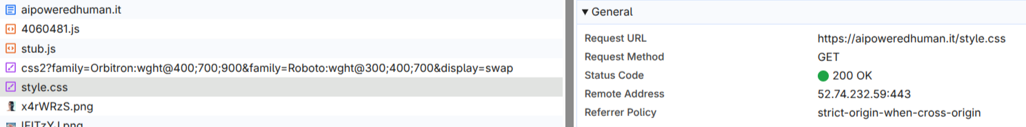

  1. It is not a pathing issue: The <link> tag in alpha.html uses the correct absolute path: <link rel="stylesheet" href="/style.css">.
  2. It is not a “File Not Found” issue: The /style.css file exists and is served correctly, as the homepage loads it without any problem.

Navigating to the root / (with cache disabled) we see:

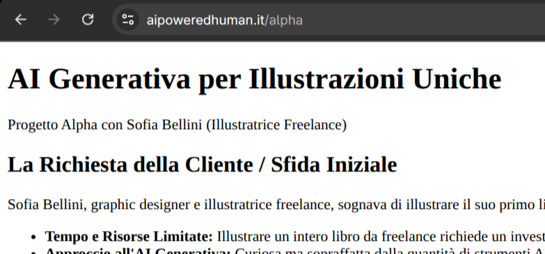

Navigating directly to /alpha (with cache disabled) we see:

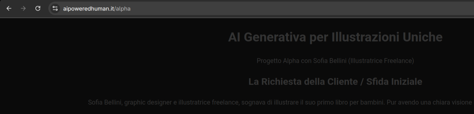

You’ve said that it “fails to apply any style and renders as a plain HTML document”.
But while it is barely styled, it is still styled, and clearly not “a plain HTML document”.

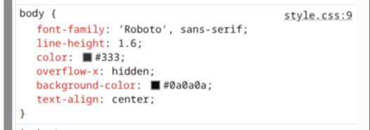

Inspecting the body of the page for example shows that the body is styled with style.css:
If you edit the page to remove the /style.css stylesheet you actually see:

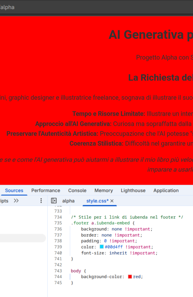

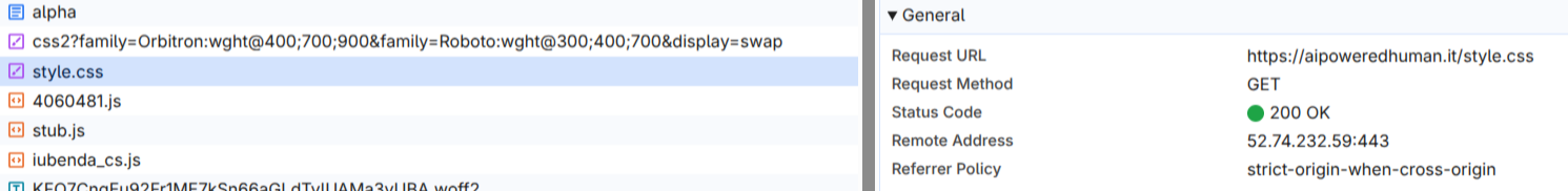

If you edit the stylesheet at runtime it applies:

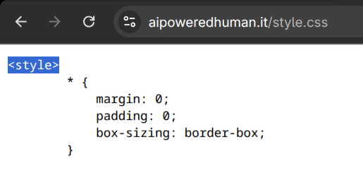

I’m not sure your /style.css should contain html
Checking what’s in /style.css, there simply doesn’t seem to be much that targets any of the elements seen on the page at /alpha.

Obviously you were 100% correct. After hours of chasing ghosts in the server, the problem was exactly what you hinted at with your brilliantly witty yet polite sentence: “I’m not sure your /style.css should contain html”. Touché.
Somehow, in the chaos of coding, a massive chunk of HTML ended up living inside my style.css file. The browser was applying the first few rules, hitting the wall of HTML, and just giving up on life.
I’ve now cleaned the file, and everything works perfectly. My sincere apologies for the wild goose chase. You saved me from going completely insane.
