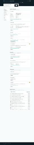

*** build settings screenshot

I took a quick look at your last deploy and it seems to be the source code for your project. Perhaps you mean to have a base directory set, to frontend/bushbass_frontend ? Looks to me like that may be where you want to start the build…
I had the base directory set, I figured out that I did not have the publish directory set, but it is working now. thanks
