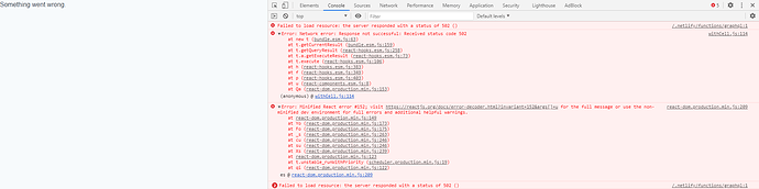

I got one more remark following the strange behavior of the deployed app, is that when accessing it, it shows up the content and quickly display the error message; do you think it’s related to case-sensitive system, which is Linux as you claimed earlier.

Hey @luke , I think you mean this:
is there some plugin/extension/addons, I can intergrade with site so they can help me troubleshoot this problem?
