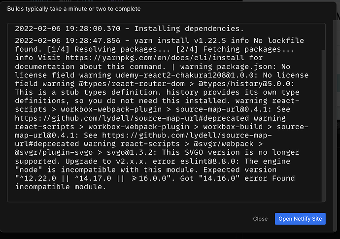

I tried to deply my React file from codesandbox, but failed many many times…
message said
“2022-02-06 19:28:47.856 - yarn install v1.22.5 info No lockfile found. [1/4] Resolving packages… [2/4] Fetching packages… info Visit yarn install | Yarn for documentation about this command. | warning package.json: No license field warning udemy-react2-chakura1208@1.0.0: No license field warning @types/react-router-dom > @types/history@5.0.0: This is a stub types definition. history provides its own type definitions, so you do not need this installed. warning react-scripts > workbox-webpack-plugin > source-map-url@0.4.1: See GitHub - lydell/source-map-url: [DEPRECATED] Tools for working with sourceMappingURL comments. warning react-scripts > workbox-webpack-plugin > workbox-build > source-map-url@0.4.1: See GitHub - lydell/source-map-url: [DEPRECATED] Tools for working with sourceMappingURL comments. warning react-scripts > @svgr/webpack > @svgr/plugin-svgo > svgo@1.3.2: This SVGO version is no longer supported. Upgrade to v2.x.x. error eslint@8.8.0: The engine “node” is incompatible with this module. Expected version “^12.22.0 || ^14.17.0 || >=16.0.0”. Got “14.16.0” error Found incompatible module.”
This error is because there is no yarn.lock file in the repository. As per this documentation Netlify will use yarn if there is a yarn.lock or the NETLIFY_USE_YARN environment variable is set to true.

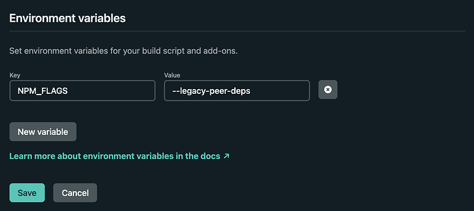

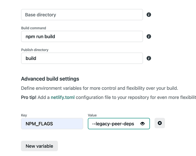

There is a issue with the dependencies for the project. This issue happens locally as well—it is not Netlify-specific. In order to install all the dependencies locally npm i --force or npm i --legacy-peer-deps is used as stated in the in the log above. To mimic this on Netlify, you need add the NPM_FLAGS environment variable (see Declare variables) with either of these values.
Thank you so much for your advice. I installed npm i --force and npm i --legacy-peer-deps but failed. Could you kindly advice what value should I add NPM_FLAGS??
I am totally beginner of these things…
