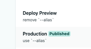

But then in Netlify the deploy is published.
When I remove the --alias flag, the logs are similar except there is no custom preview URL but Netlify doesn’t publish:
The only difference in the commit is the removal of --alias.
