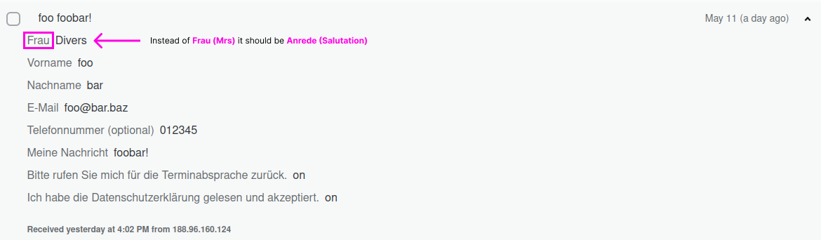

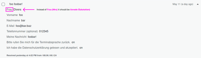

After trying out a couple of things I got the feeling that I didn’t explain my problem very well.
All form values in my form are submitted quite fine.
My problem is with the labels which are used in the email and on Netlify under Verified submissions.
Here is a screenshot:
The label for salutation which is a radio group is wrong.
The label is the value of the first radio button but IMO the label should be the name attribute of the radio group.
I hope this explains it.
And now I try to figure out how I can either fake it or get it done correctly.
The issue here then is Anrede is the text in a <h4> and is not associated with the <fieldset> nor with any of the options in the field set.
Try giving the <fieldset> a name attribute and/or add a <legend> tag (see <fieldset> on MDN) as these are what describes the field set.
