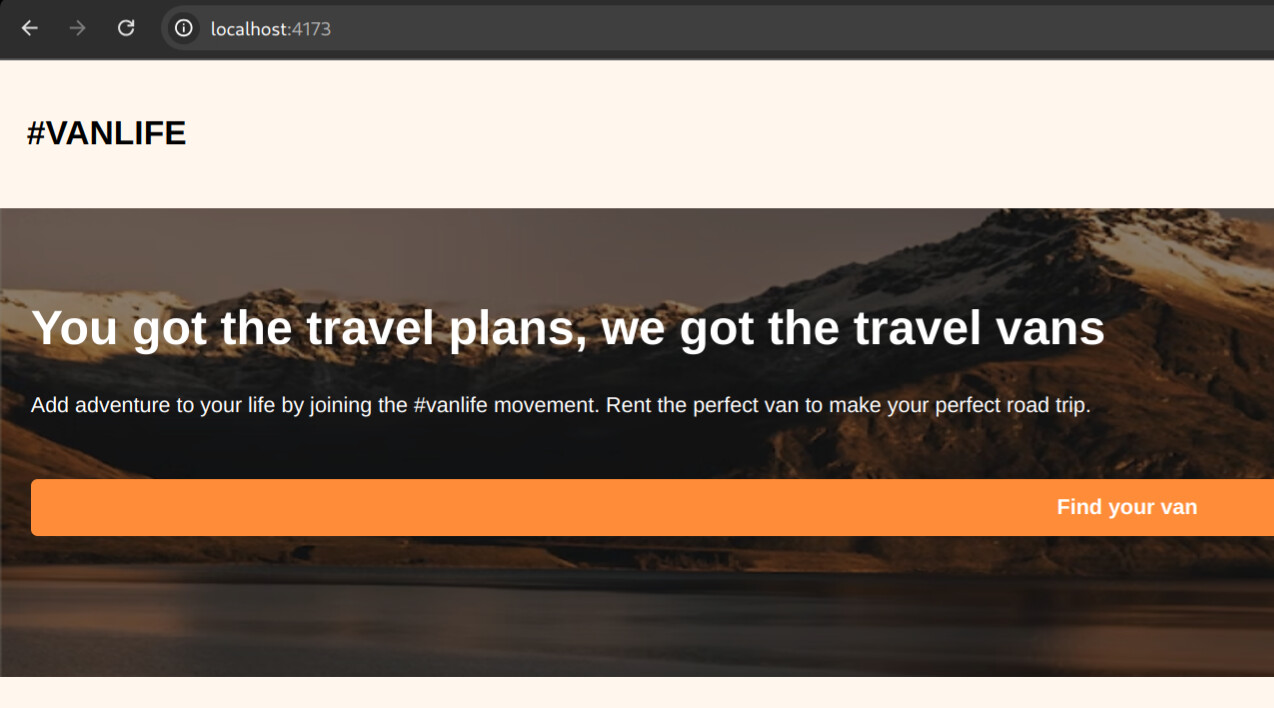

I am deploying this site and on the home page the asset home-hero-img is showing but in the about page the about-hero-img is not although they are in same folder

Run your build locally and you’ll see the files it outputs:
View your build output with npm run build && npm run preview to see the same as on Netlify:
