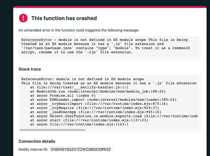

Everything works well, except when I’m using Netlify redirects. For example, I have https:/pratik.is/here redirect to the root index page with the following rule:
/here               https://pratik.is/     200
However, if you navigate to https:/pratik.is/here you will see the following error:
Other notes:
Fixed it by moving the _redirects file to public/ for my NextJS project, following the directions at the bottom here: next-runtime/redirects-rewrites.md at main · netlify/next-runtime · GitHub.
I was upgrading from a prior plugin version and it started this issue.
