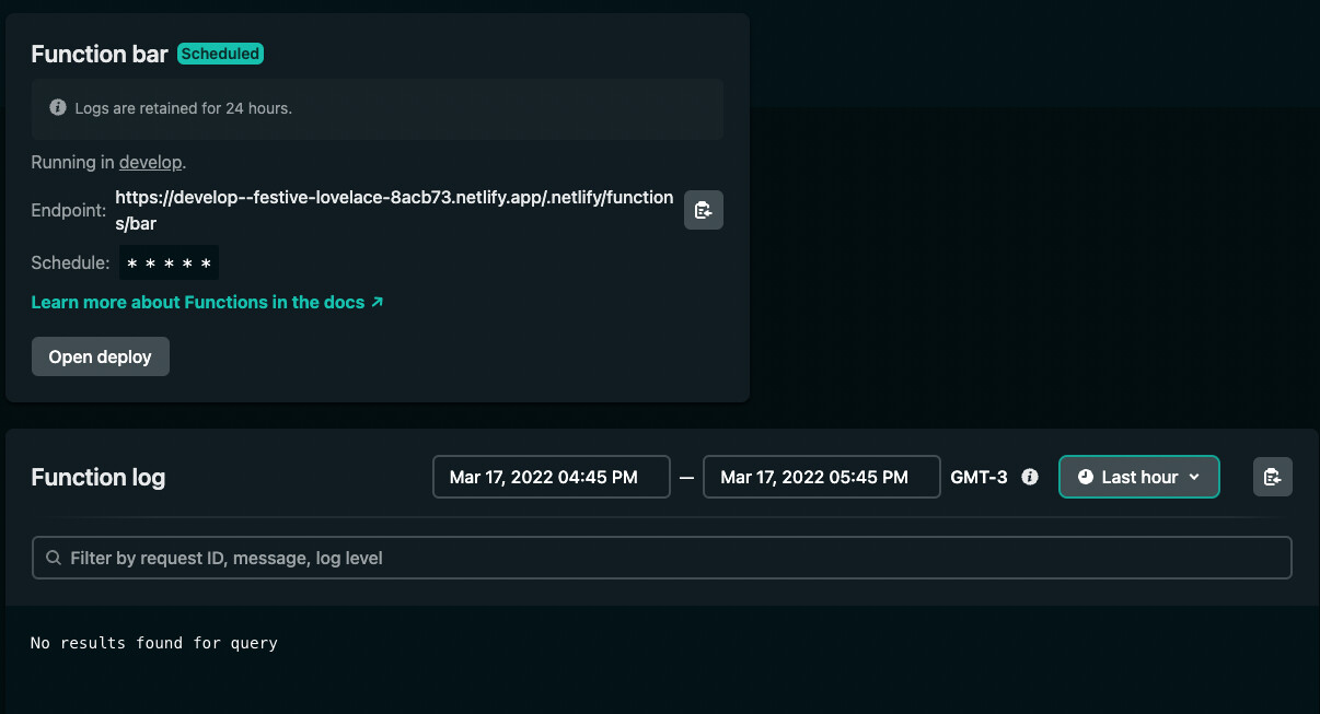

“Latest” shows no logs for me on all functions. Changing it to “last hour” shows “No results found for query” even for the simple function I posted above. My understanding is that console.log, console.warning, etc should end up here if the function executed? I don’t think they are executing at all if that’s the case

So I created a test site and can confirm I see the logs for this function https://github.com/gaspardip/remix-scheduled-functions/blob/master/netlify/functions/foo/index.ts
I wonder if me not being the owner of the other site might have something to do with functions not executing? maybe the owner has to enable scheduled functions through labs too? I honestly have no other explanation.
Ok I think I found the issue, functions published to any branch that is not the production branch are not being run, check these functions https://github.com/gaspardip/remix-scheduled-functions/tree/develop/netlify/functions, and their logs
As per below, they only run on the main/production branch (at this point; when they are out of labs this may change.)
Well that wasn’t mentioned in the docs anywhere, would be useful to have it there imo. It’s quite unfortunate because we are using branch subdomains and our default branch doesn’t have the same content as develop (they are even different builds, default branch is the landing, develop is the development branch for our app). I guess the workaround for now is to include the relevant code in the default branch.
