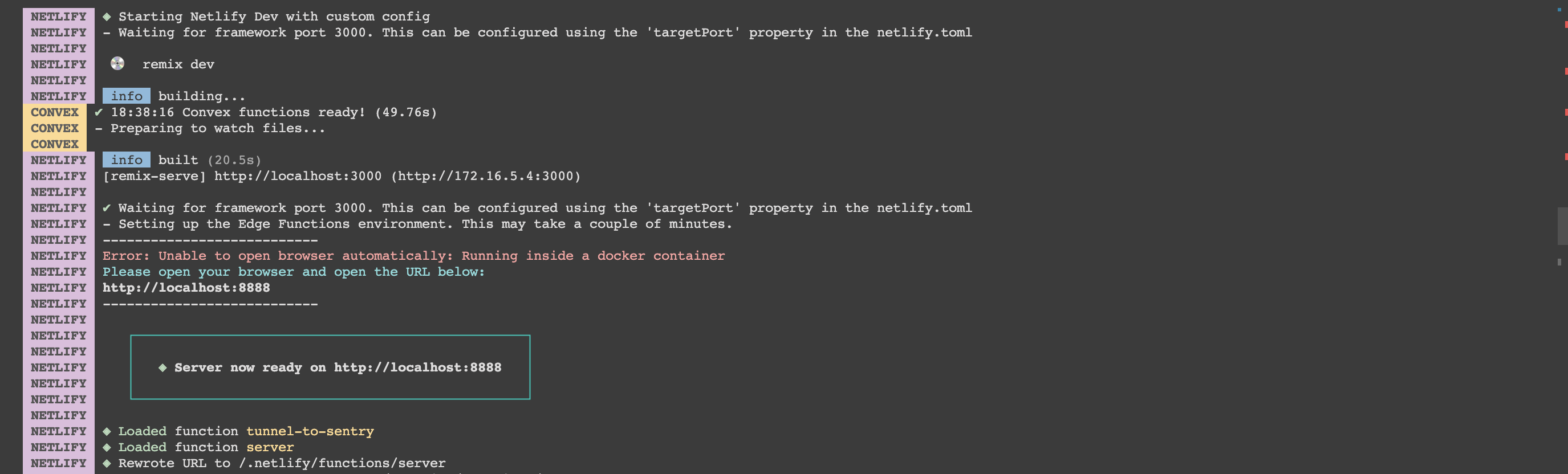

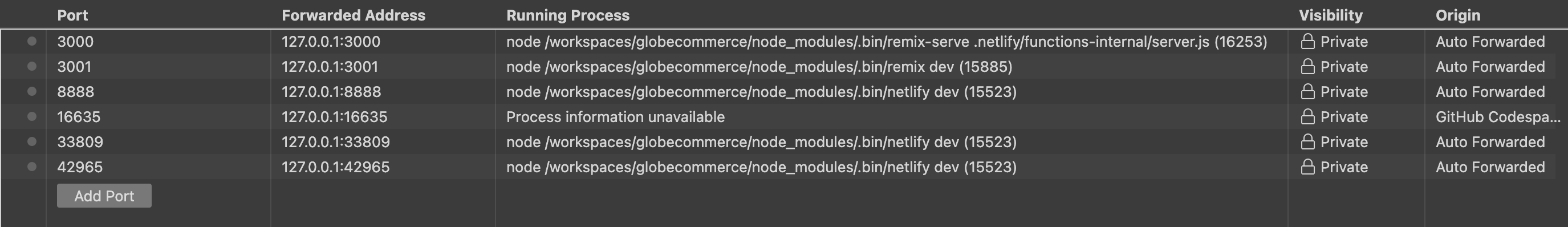

Today I’m developing on a different machine than usual, and on this machine I prefer to host my dev environment on GitHub Codespaces. I tried running the Remix dev server in this context, and found that
When navigating to the port (8888) that Netlify said I should use to access the dev server, I saw the same error I reported above, but
When navigating to the port that Remix said it was running the dev server on (3000), the app worked.

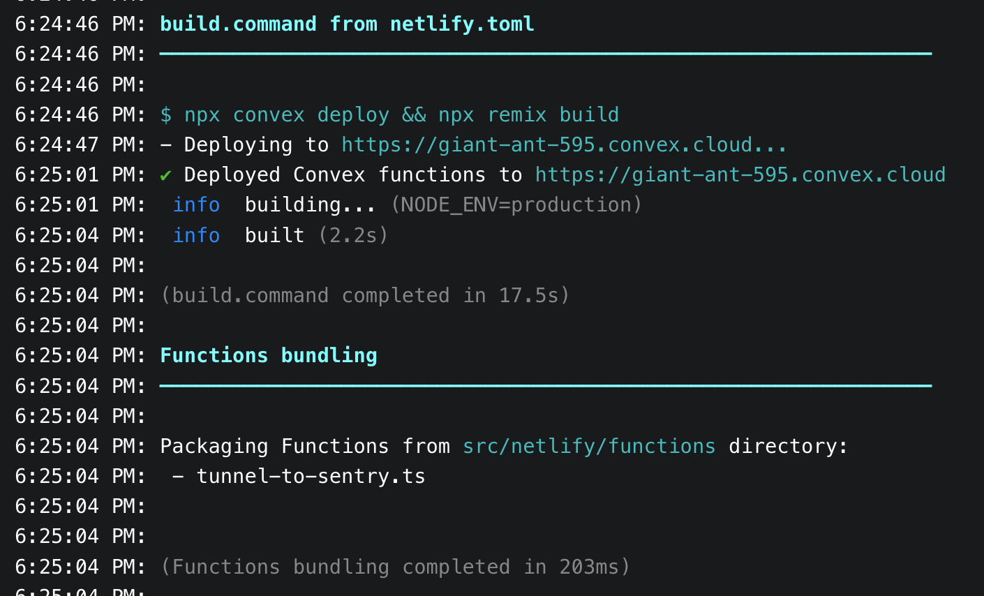

This has resolved the issue of serving the Netlify server function in development (at the port provided by Netlify—see my previous message for more details), but I’m now seeing a new problem in production—Netlify seems to not even see the server function.

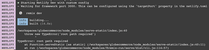

I’m now properly spreading the @netlify/remix-adapterconfig, and am seeing the following error in development (I have not tried to deploy to production):
That’s an interesting error It looks like it’s coming from the Remix Dev Server, not from the Netlify CLI. Have you searched the Remix GitHub? Maybe there’s an issue there about it.
If you provide me with a reproduction repository, I’m also happy to take a look and debug it. We don’t typically look at user code, but learning more about the Remix internals is always good
