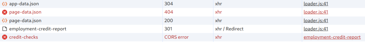

Look at the Network tab of your developer tools.
Direct Access
When accessing the URL directly you see:
This is because a request was made for that URL, Netlify’s redirect engine responded and redirected.
Site Link
When you click the link in your page you see:
Your SPA has internal routing that makes a request to:
https://www.goodhire.com/page-data/screening/employment-credit-report/page-data.json
(which does not exist)
It also attempts to retrieve the external URL via ajax:
https://checkr.com/background-check/credit-checks
(which is blocked by CORS)
It then displays its own 404 page.
No actual GET request is made for the window to visit /screening/employment-credit-report/ so Netlify’s redirect engine isn’t even involved.
The solution will be to adjust your site, and I can’t advise precisely how you would do that.
Ultimately you want to ensure that you either:
  1. Have the page actually navigate to the URL when clicked so that Netlify’s redirect occurs.
    OR
  2. Duplicate the redirect/external link into whatever SPA routing you have so that clicking on it ends up on the external page via other means.
