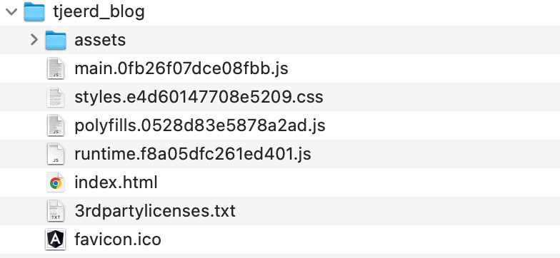

I can download a zip from netlify and run it local. It has in the root an index.html

Are you able to show the file structure of the zip you downloaded?

So you’ll find that the site is actually under https://sprightly-tapioca-dc7edf.netlify.app/tjeerd_blog/
, as per the structure of the zip archive.
This is in line with the configuration in the project angular.json
"outputPath": "dist/tjeerd_blog",
Either changing this value to dist
, or changing the publish directory to dist/tjeerd_blog
will remedy the Page Not Found error.
