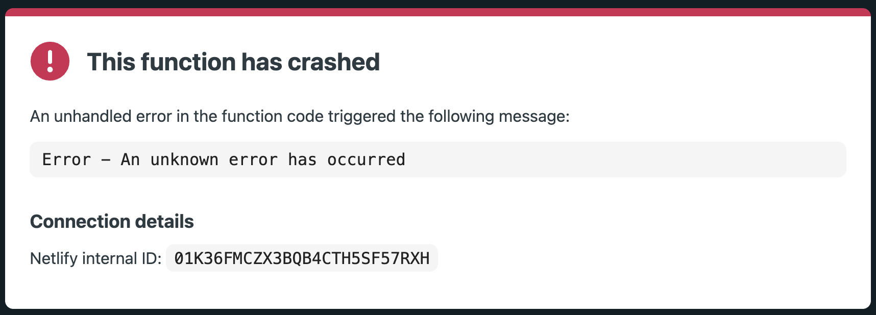

Hi, @lassejaco2. I cannot find that request id (which appears to be `01K1BD204YM0XJR3VMΚΗΚ01M64`) anywhere in our access logs. What site is this about?
