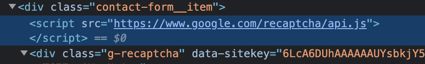

The problem is with your site’s JavaScript and not Netlify. As you can see, Netlify is adding the ReCaptcha whenever the page is requested - but when your site’s JS tries to load the page, it doesn’t append the required <script> tag for some reason.
This is the page that Netlify serves:

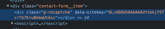

This is how your site’s JS shows the page when you navigate to it from the navigation:
Now we don’t know why that’s happening, as it’s not something caused by Netlify - you can confirm by disabling JavaScript in browser settings and trying to load the page - ReCaptcha would work fine even when you navigate.
Not sure if you’re using some jQuery plugins or something else, but in the past, when I had used something like: Turbo Handbook, I had to manually manage the JavaScript - in the sense, handle specific events. Maybe you can try adding the script tag on-demand to see if it works. I tried doing that on your site and that works too:
