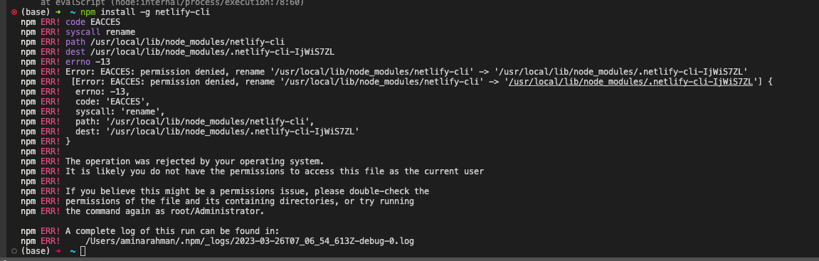

Firstly, sudo npm install -g netlify-cli command produced an empty ā€œnetlify folderā€.
So, there’s no config.json file in my directory. This time I ran the command the ā€œ/Users/aminarahmanā€ directory. Please help me. I also tried to run the installation command from my project directory.
Here is another attempt. I uninstalled first and then tried npm install -g netlify-cli and sudo npm install -g netlify-cli. Here are the errors I get. The ā€œconfig.jsonā€ file is empty.
This is not a CLI issue. It’s your OS not allowing CLI to write to some directories. You might have to check all permissions across your device.
Screenshot 2023-03-26 at 2.26.49 PM
Here it is. Thank you for the reply. How can I change the permission and which one?

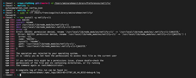

Hello, Luke, I saw those and tried the first one earlier. I somehow managed to install using sudo npm install -g netlify-cli once, where I got the empty ā€œconfig.jsonā€ file. Here in the screenshot, I deleted my current ā€œnetlifyā€ directory as said in the first link and you can see the rest.
I also tried to manually change the permission (Read&Write for all) as said in the second link.
Then I tried running netlify. But got this
" Error: EACCES: permission denied, open ā€˜/Users/aminarahman/Library/Preferences/netlify/config.json’
You don’t have access to this file."
Maybe I don’t understand the instructions given in these solutions. I am trying to follow everything suggested in those links.
Please help me. I’ve tried as much as I could. And it’s something that I don’t know who else can help me other than the Netlify team. :sob:
