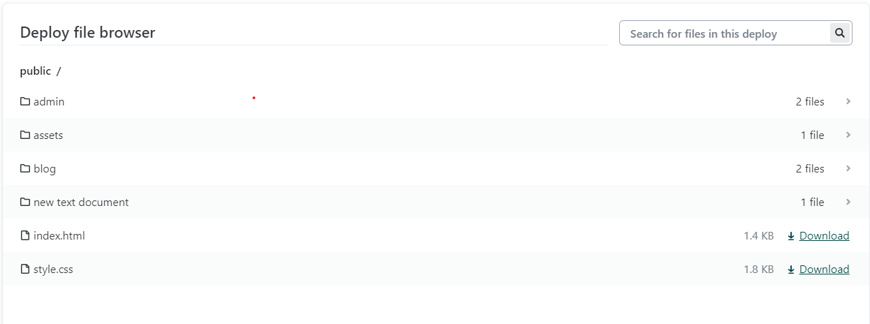

I use eleventy for my blog. the main page isn’t showing up. i think the problem is that the index.html file is gone.
this deploy from 2022 has index.html:
Hi @rbman, thanks for the post and welcome to the Netlify Support Forums.
Your deploy file browser clearly shows that the index.html file is present.
First of all have you recently made any changes to your code and pushed the changes to your repository?

thank you for responding to me, i highly appreciate it.
the photo i showed is a screenshot of an earlier deploy, on 2022. this is a deploy from yesterday, which has no index.html:
i also have left the website dormant since 2022, i haven’t made any edits since then.

@rbman When I run your build locally I see:
After which the files inside public match the ones you’ve shown on Netlify:
Your build doesn’t produce an index.html in the root.
Two years ago you had an src/index.njk file that can be seen here:
https://github.com/Rendangbike/blogcms/tree/7a227ed3bca3a3ebd8dbc8849e11dd2e0c737b36/src
You moved it to src/_includes/index.njk in this commit on 2023-01-05:
https://github.com/Rendangbike/blogcms/commit/ce94e1833be402a6c64f026f212ecaab92fcb0b4
So it’s now in this location:
https://github.com/Rendangbike/blogcms/blob/main/src/_includes/index.njk
I don’t see any issue with Netlify here, this is just due to your own project code, you should adjust as necessary depending on what you’re trying to do.
