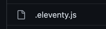

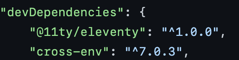

I don’t know what Obsidian is, but here’s why it appears you’re using eleventy:
Your repo has this file:
This is from your package.json:
You’re using .njk templates:
You’ve a file structure that Eleventy sites generally have:
tl/dnr: I got it. I added a line to the eleventy.js file to create a static folder.
