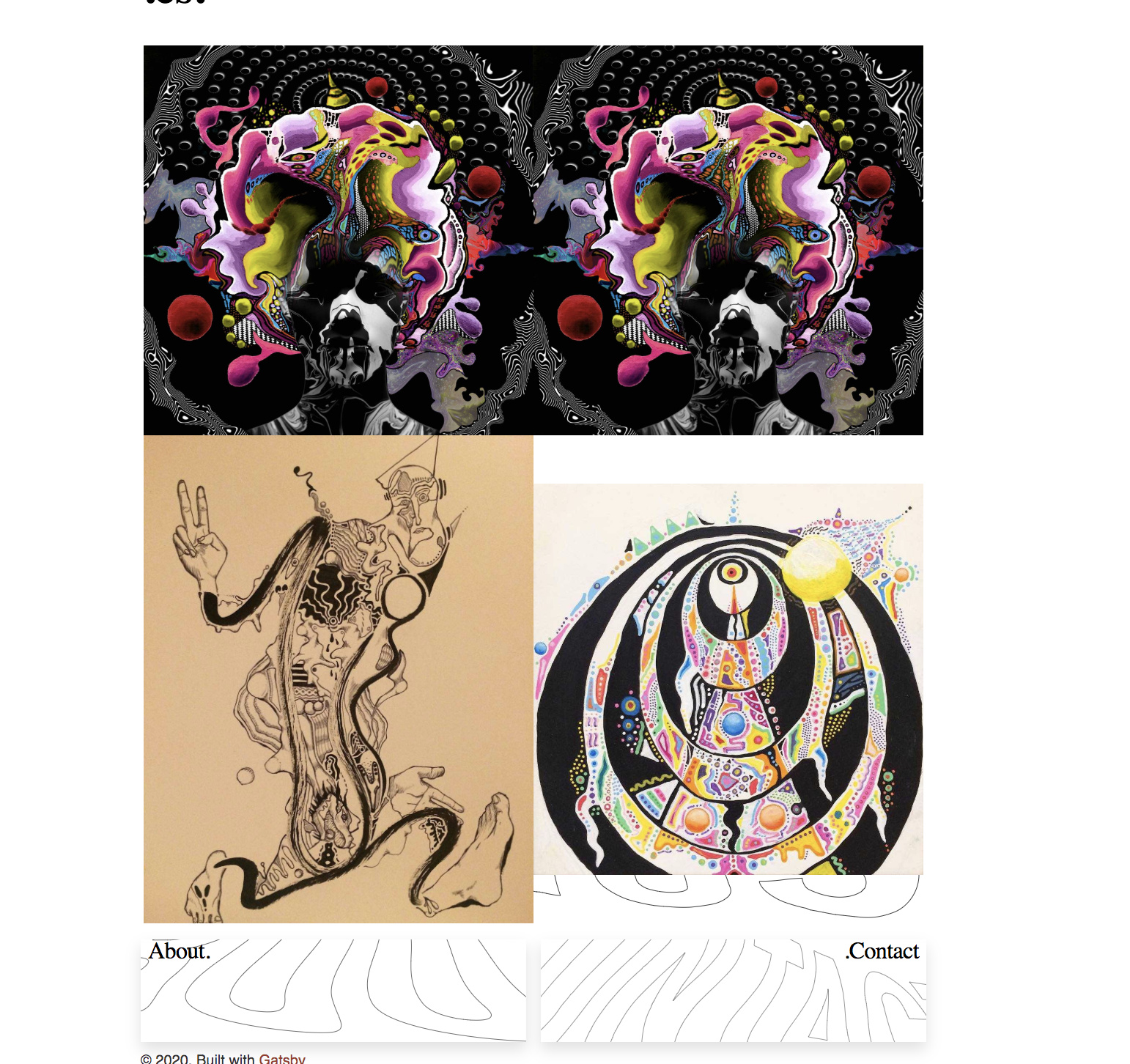

I am seeing this on first load:
But, that said, I agree with you - the images are low-resolution and blurry at first, before coming in to focus.

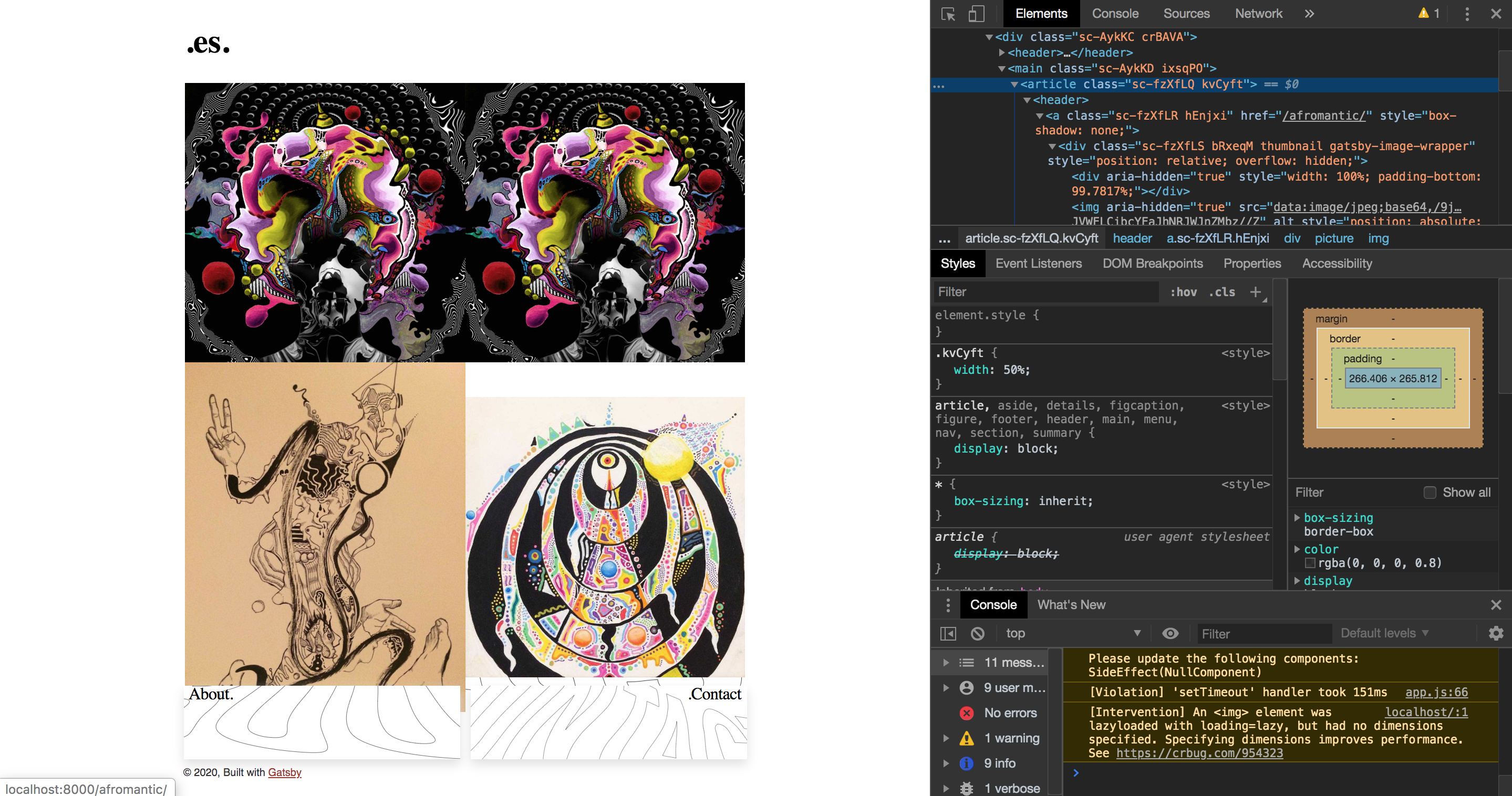

Here’s the screen shots of local and live:
Local

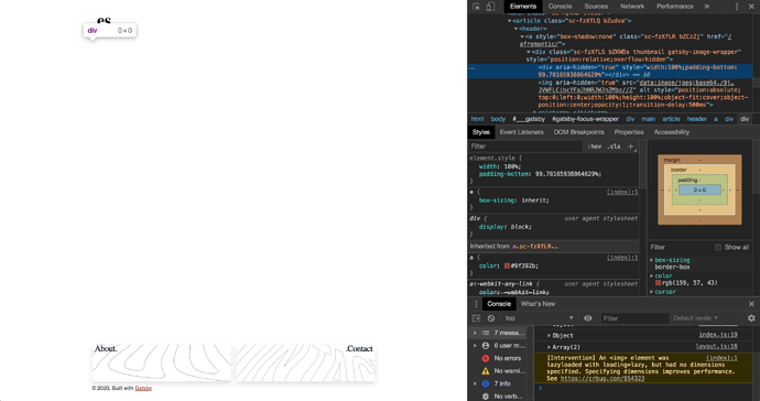

Live
You can see the width property is not even there on live site and element dimension is 0x0.
I just ran yarn upgrade --latest but still didn’t fix. So far only way to get it to work is not to use the styled components.

From looking at the site, it appears that Gatsby is adding aria-hidden attributes and not respecting the height/width. This is probably worth bringing up to the Gatsby team (Issues · gatsbyjs/gatsby · GitHub), since that definitely shouldn’t be happening.
